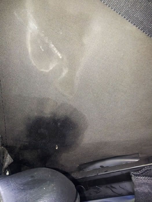

The following picture was pre reproofing:
At least and at the moment since reproofing this IS NOT happening any more, jury is out until we get a good sustained blast of rain.
